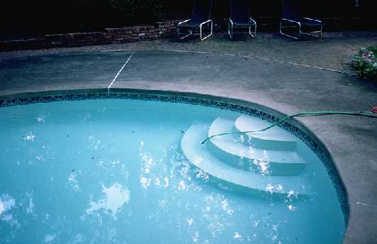

A leaking swimming pool By far the most common indication of a leak is that the water level is dropping faster than what is normally attributable to evaporation or splash-out. Often leaks are big enough that excess water loss is obvious. If you wake-up to find that your pool has dropped several inches overnight you know you’ve got a problem. The bigger challenges are the smaller, yet just as serious, leaks that may develop slowly. In these cases it is important to determine what is “normal water loss” and thus avoid wasting time looking for and worrying about a leak that really isn’t there. A simple way to account for evaporation and confirm a leak is to do a Bucket Test, or for more accurate results to purchase and use a Check-A-Leak System.
