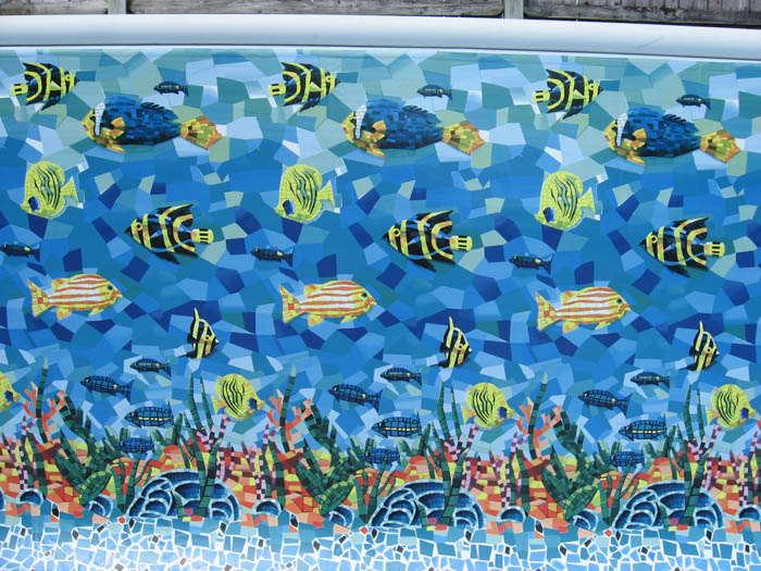

I have attached a file of a pool liner we did this past summer. Its a beauty. I tried to talk them out of it!!!

Take Note
I got a response that my file was too big hence, it didn't make it. I don't know that the file size limit is here. I will try it again to see if I can determine a good size.

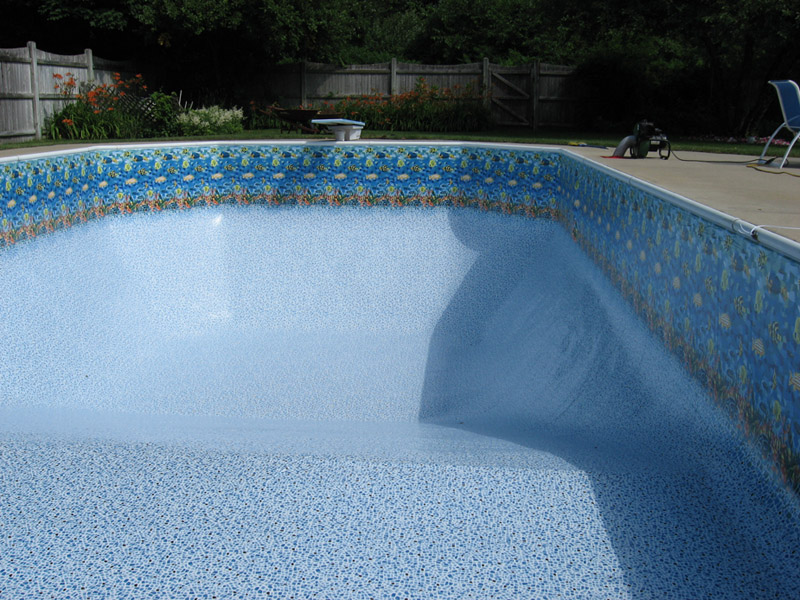

I shrank the image
This was a 150k image and it works so until we get a reply from the site ops we know that will work as an acceptable size. The following photo is 211K

4LeakMan, I can't see it to well... what is that piece of equipment on the deck between the pool and the chair? Is that a compressor?

Liner Vacuum
It is a liner vac, used to draw the liner into place and allow positioning of the liner for proper installation without having the liner move before the water is added. Works great. I used to use 1 or 2 blower/vac combos but this one unit does (Q-vac) works just fine by itself.

:cool: Nice liner, ummmm. Put one in UK that looks like prawns swimming around the tile band, yum!
Can't be without a liner vac if you want a good easy fit I find, we have done them and it held them in so well did all the cuts before filling. Better that freexing feet in the winter.:)
